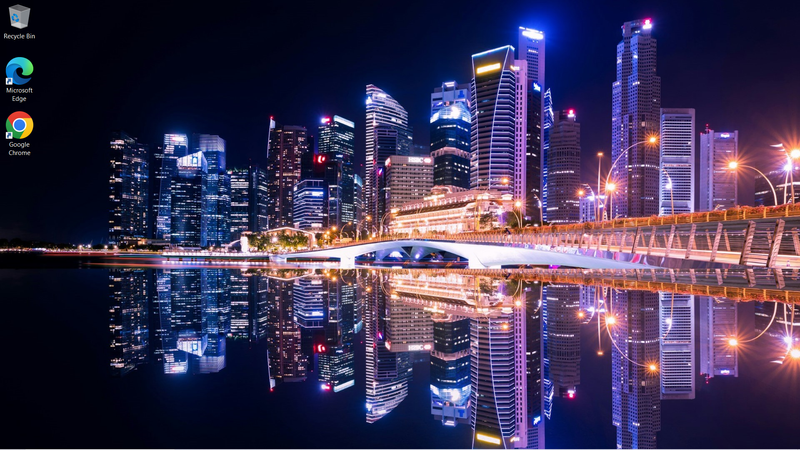

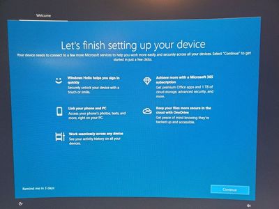

The issue is, the taskbar is locking closed at login, on startup. I move my mouse over and over to draw it out and it remains hidden(observe the 1st image). I have to push the WINDOWS key(observe image 2) and then push the WINDOWS key again before it becomes interactive.image 1image 1image 2image 2

In this scenario it appears to be the exact same outcome, the OS appears to load properly, shows my user account and personal photo, and then after I enter my user account password it loads as if it is entering my user account normally, but then displays the 'setting up device' screen.
I believe the Windows Recovery Environment might've been the wrong term I used originally. I found a picture online to show the mode it's entering.
