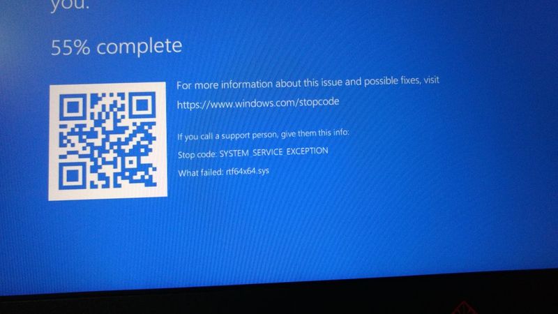

             I have bought a new HP OMEN laptop a month before and i just updated all the drivers from hp support assistant. After that i am facing a bluescreen error issue. It says Stop code: SYSTEM SERVICE EXCEPTION.
 What failed: rtf64x64.sys
             i have got it almost 3 times unexpectedly while running laptop in idle mode.

Hi! @Asuthosh, Thanks for stopping by the HP Support Forums!
I understand when you boot into your PC you are getting a blue screen with error rtf64x64.sys on your PC.
Don't worry I'll try to help you out.
Did you make any software or hardware changes on your PC?
Please share the blue screen error on your PC to assist you better.
As you mentioned when you boot into your PC you are getting a blue screen with error rtf64x64.sys on your PC.
Try restoring the BIOS to default and check if it helps.
  1. Turn off the computer and wait five seconds.
  2. Press the Power button to start the computer and repeatedly press the F10 key to enter the BIOS setup menu.
  3. On the BIOS Setup screen, press F9 to select and load the BIOS Setup Default settings.
  4. Press F10 to Save and Exit.
  5. Use the arrow keys to select Yes, then press Enter when asked Exit Saving Changes?
  6. Follow the prompts to restart your computer.

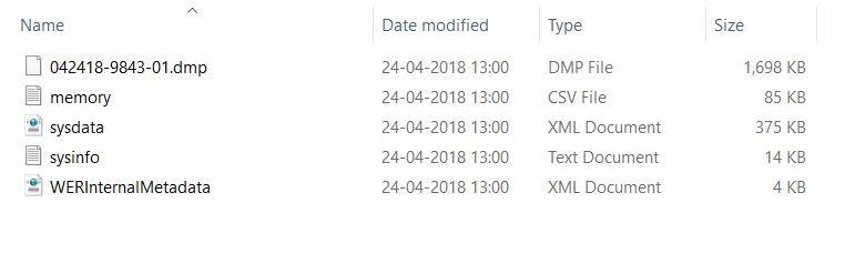

for your referal i got the bluescreen error yesterday and after which i have got some information from reliability monitor.
check out the pics.yesterday's report with 2 bluescreen errorsyesterday's report with 2 bluescreen errorsthis is the detail of 2nd bluescreen errorthis is the detail of 2nd bluescreen errorthis is the temp files generated about the errorsthis is the temp files generated about the errorsthis is the detail of first bluescreen errorthis is the detail of first bluescreen error
