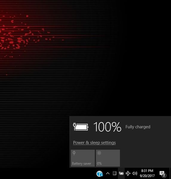

Yes i'm using the F2 and F3 keys (Fn + F3) and when I choose display settings after right clicking on desktop I don't get the option to increase or reduce brightness.I realized i cannot adjust screen resolution from display settings also and when I click the battery icon on the task bar brightness cannot be adjusted from their either.

I did what you asked, check photo attachments for test log and device manager findings.
Edit, the Images posted are showing now.
The two Other Devices shouldnt affect the Screen. Ive read that they might be related to a cellular phone connection to the PC, but Im not entirely sure.
The only thing I can guess is either the video driver is corrupt and needs to be uninstalled completely before reinstalling. Or perhaps something physical is wrong with the screen, ribbon cable, etc.
