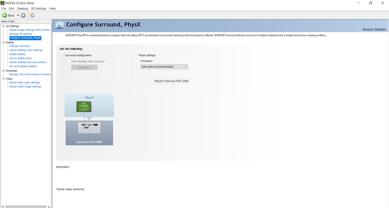

Update: The display is getting detected but Nvidia RTX  2060 detects it as a Laptop Display, therefore, giving no output to the actual secondary monitor. Please help further. The USB Type- C controller still doesn't start.

The driver sometimes detects the external monitor while sometimes it doesn't detect. This is might be due to wrong/ unstable Nvidia drivers pushed up with Windows Update.
I'm still not able to find the correct solution to this. Please help.
