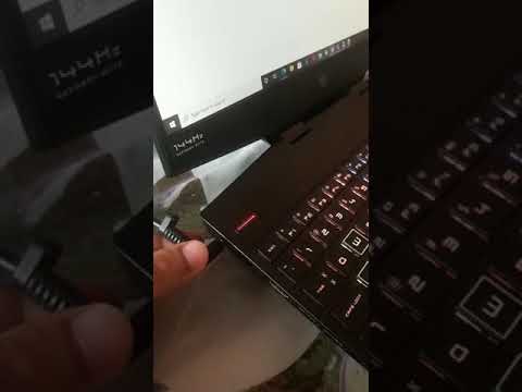

My laptop sometimes does not charge when connected to a power source. It is a very weird issue as it comes suddenly. I have made a short video describing the issue. https://youtu.be/JHEMeUjdZq4
The HP Omen 15 has this weird charging issue. It always charges when the laptop is shut down and sometimes charges as can be seen in the video. This video does not provide any solution but describes a major HP laptop issue that they don't have a solution to.

Hello, thanks for the response.
As my laptop is in warranty, technician came and he found motherboard to be defective which was quite strange and surprising to me(4 months old laptop).
Let's hope it gets fixed soon.
