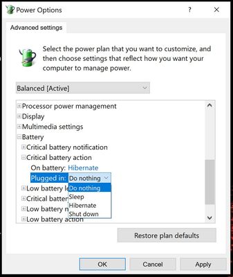

3. Change Critical Battery Action... Right click on battery icon in system tray>Power options>Change plan settings>Change advanced power settings>(in the pop up window, under the Battery category)Critical battery action (and expand the + sign) > In the list find... Plugged in: and change it to Do Nothing.
Hope one of those helps.
