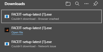

Update 3 : Tried downloading with Edge.
1st attempt - Couldnt download. Network issue. (tried with the option "open")
2nd attempt - Downloaded (tried with the option "open" again)
3rd attempt - Browser crashed (tried with the option "save as" since the previous attempt downloaded the file but could not open file location).
This is getting really annoying and frustrating now.
