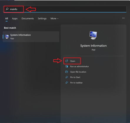

  1.  From Search ->   msinfo32 and open
  2.  From System Information, identify Virtualization-Based Security Status is enable (Running) or not
