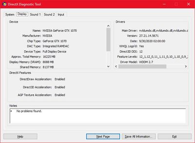

10-12-2020 04:35 AM - edited 10-12-2020 04:45 AM
Hello and thanks for your return,
Please verify that all DirectX Features are enabled as follows:
- On the keyboard, press the Windows and R keys simultaneously. The Run window will open.
- Type dxdiag, then press the Enter key, and then click Yes. The DirectX Diagnostic Tool window will open.
- Click on the Diplay tab, and check the DirectX Features:
- DirectDraw Acceleration
- Direct3D Acceleration
- AGP Texture Acceleration
- If in front of one of the above DirectX Features you have a bonton Enabled click on it.
- Click Exit.
- Reboot the computer.
Don't hesitate to contact us in case of need.
