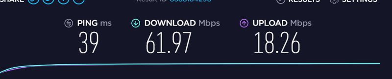

Speed tests carried out while not downloading anything show great speeds, exactly what I'd expect:
But whenever I start to download anything, and it's showing as only 7-8mb/s, speed tests give the below results:

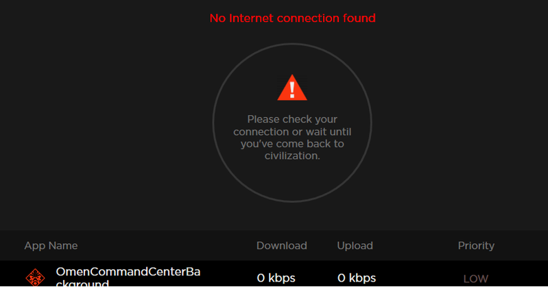

In regards to Omen command centre, it's showing as receiving a decent DL rate of 50+mb/s, though interestingly when I look at Network Booster it saying I'm not connected to the internet when I am.

Oh I see. With the exception of the Omen Command Center being screwed up, everything you show is absolutely normal that I can tell.
Your browsers speed test shows high when ran by itself, but goes way down while downloading a game or game updates. Mine does this exact same thing.

As far as the OCC is concerned, You might try uninstalling it, rebooting and reinstalling from the MS Store. Should be version 8.2.10.  Then go to Windows updates and force it to search for updates. Even if it already shows its up to date, click the Check for updates button and let it do its thing. Usually that's all that's needed to fix the OCC.
Let me know if that helps.
