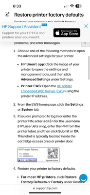

Hey so i was able to finally fix my issue. I factory reset the printer then uninstall and install the HP app again. Then connected my printer as if it’s a new printer. Hopefully this works for you too. I followed the steps below.
