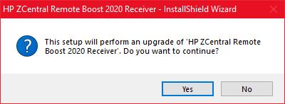

We are currently upgrading our workstations from Sender 20.1.0.26348 to 20.1.2.8161
The existing release has been installed per command line and has worked flawlessly on all our workstations.
The upgrade procedure is in principle equivalent, but when issuing the command
SenderSetup64.exe /z"/autoinstall /agreetolicense /usb /clipboard /el /noreboot"
instead of upgrading silently the message
"This setup will perform an upgrade of 'HP ZCentral Remote Boost 2020 Sender'. Do you want to continue?"
(see image below if I will ever manage to upload it)
This interactive request breaks the unattended upgrade our workstations. I have been searching in the user manual, but did not find anything regarding "Upgrade from Command Line". How can we override this messagebox from the comman dline?
interactive message breaking unattended upgrade
Solved! Go to Solution.
04-07-2021 12:06 AM
...actually trying to upgrade the Receiver from command line brings up exactly the same message, breaking the unattended installation procedure as nobody will be there to click on "Yes". This makes a systematic unattended upgrade of the ZCentral components technically impossible.
Hopefully a solution will be offered on a short term, as otherwise a minor update will become a huge task in our scenario, and currently we do not have resources for this.
RGS Receiver upgrade from Command line broken by popup window
Just in case the website does something wired not showing this image, I will report down here the full message that is displayed:
"This setup will perform an upgrade of 'HP ZCentral Remote Boost 2020 Receiver'. Do you want to continue?"
...of course I want to continue: the question should not even be asked when shooting the commandline command with the
/z"/autoinstall /agreetolicense /noreboot"
switch
