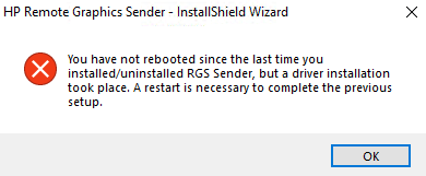

Hello,
I repeated installing and unstalling various version of RGS Sender for a testing.
Now I encounter the error below when starting the 7.5.1 SenderSetup.exe and am impossible to install the RGS Sender.
I have already rebooted the PC again and again.
rgsCleanInstallFiles.bat has been tried to execute but nothing changes.
Here is the spec of sender PC:
HP Z240
WIndows10 64bit
RGS Sender 7.5.1
NVIDIA version 385.69 Quadro P2000
Could anybody help to resolve this issue?
Thanks.

02-19-2019 11:56 AM
Just to verify, there are no other installations of HP Remote Graphics Sender installed, or visible in the control panel. The other thing to try would be to stop the sender service, launch the SenderConfigApp.exe which is located where the sender is installed, and then at the bottom of the genera screen, click on the link to reset to default. Restart the sender service.

02-08-2019 03:09 PM
What version of RGS did you have on your sender prior to installing RGS 7.5.1? If it was RGS 7.4.0 was it 32bit or 64 bit version? RGS 7.4 was our first 64 bit release for Windows. When you uninstalled the sender, did you check to remove the user's settings? How are you doing the installation, via command line or using our executable? When uninstalling, are you going through the Control Panel?

02-11-2019 08:53 PM
Unfortunately I don't remember well which version I tried. Probarbly later than 7.3 are included and both 32bit and 64bit were tried.
I checked to remove user settings when uninstalling.
The install were done by executable file and uninstall were done by Control Panel - program uninstall.
02-19-2019 11:56 AM
