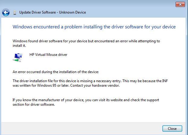

Further I have found another issue with Vmouse setup when trying the work on the sender node. HP VMouse.JPG

Hi,
The client machine on which the Sender is installed is on VMware with Windows 7 Enterprise SP 1.
Processor: Intel Xeon CPU E5-2667 v3 @ 3.20 GHz 3.20 GHz
Ram: 122 GB
System Type: 64 bit.
Graphic Driver: NVIDIA Graphics Driver 362.56
The Vmouse issue: Error Message: Driver installation failed
Thanks for the info.  What ESXi version are you using with VMWare?  You should not need the VMouse with Win 7.  Are you having trouble with the mouse, or is this a headless system with nothing attached to it such as a server?  I am going to reach out to you in a private email shortly.
