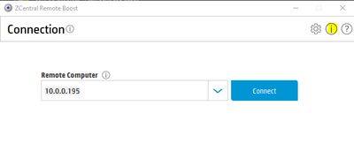

Thanks for the response, but would like to have the actual version.  You can find this on the receiver very easily by clicking the lower case i in the receiver when you have launched it.
