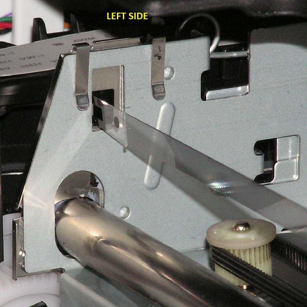

The third picture is the left side. The metal tang the encoder will connect to is difficult to see. It is a small (perhaps 1/16") metal protrusion that points toward the left side of the printer. Use a flashlight to become familar with the tang that you will eventually connect to. As practice try hooking the encoder strip to the tang on the left side, then disconnect it.
