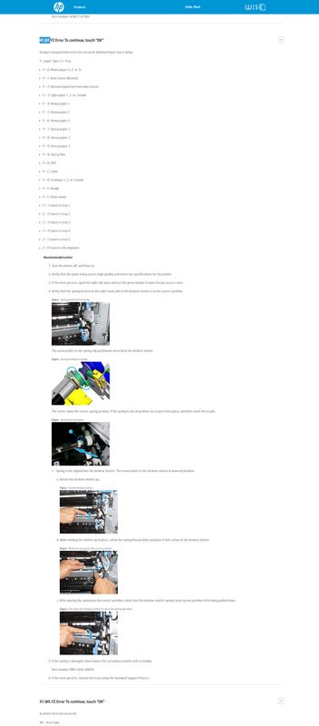

This may help, from the troubleshooting manual. I attached below as a file as well because it might be difficult to read.
