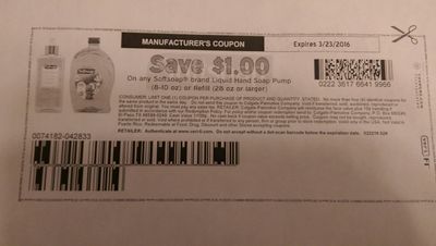

Every time I print a coupon (from multiple sources, coupons.com and coupons.target.com), the barcode gets blurred together in some spots, making the barcode illegible by scanners.  Below is an example:
I have tried reinstalling the coupons.com printer device software, with no luck.  Any suggestions would be helpful, I cannot seem to find the same problem on any forum.

This appears to be an issue related to job processing or missing font information etc.
I believe that you must be using built in drivers available in the Windows 10 OS.  Please check if a Postscript-PS version of driver is available and try to use the same.
You may also try to print the job as an image.

I tried the HP Universal Print Driver for Windows PCL6 (64-bit) , tried the post-script driver, with bitmap option enabled or not, still the issue... bad drivers!
I have the same exact problem with my HP LaserJet 6L printer.  The PS Class driver does not work at all - and the standard driver causes the coupon barcodes to print exactly as you have shown in your photo.  HP, can you please resolve this problem for Windows 10 users!!!

The problems are not limited to barcodes.
I also found smeared letters in some documents.
