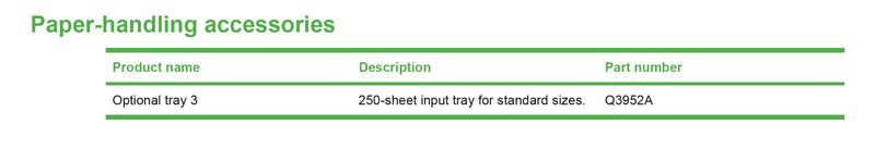

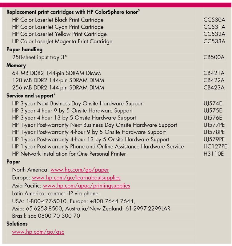

QUESTION: What is the correct part number for the option tray 3 for my printer; Q3952A or CB500A? And, why does the HP literature use two different numbers for this? It seems they are not the same item.
On page 247 of the User Guide (CC434-90907) it shows the part number is Q3952A.
But, on page 3 of the sales brochure (4AA2-0270ENUC, July 2011, Rev 2) it shows the part number to be CB500A.
