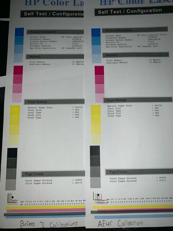

On the printer go to the reports menu and print a configuration report.  Look at the colored bars at the bottom of the page. If they are off go to the print quality menu and run the calibrate routine 3 times in a row.  See if that helps.  If not post a copy of the last config page for us to evaluate and give you further instructons.  Calibration occurs at the printer and nothing to do with your upgrade or the computer.
Here is my before and after. I configured it 3 times and it appears to have made it worse. Please helpimage-17-09-19-07-05.jpeg

Still misaligned.
The printer is still misaligning. Is there anything else I can do??? 10B8605F-962E-4909-8FDB-72DFB666F329.jpeg
