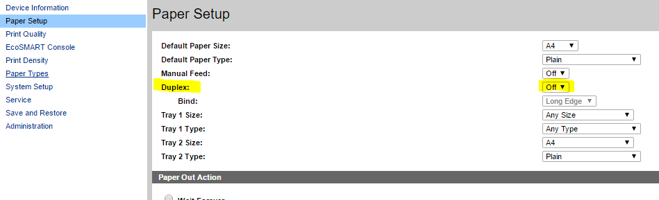

With that model, it is possible to set the printer's default Duplex print action to either On or Off:
This is done via the Embedded Web Server - so you'd need a connected computer to do it - I don't think that the front panel menu system offers the option.
Even with the option set to On, this is only a printer default - so it will be over-ridden by any printer 'commands' within an incoming print job which specify the plex mode - most print  jobs do, but not all.
... and the same is probably true of a 'walk-up' PDF file on USB - I don't know whether or not these have any internal 'properties' which identify the required plex mode, or not.
You sir are a genius! I took my laptop down tonight and configured the printer via the web browser to enable duplex print and hey presto it worked. Thanks again for your help.
