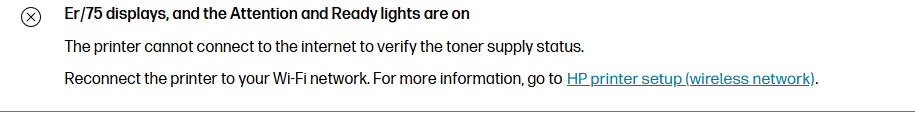

Error 75 after installing new cartridge
1 REPLY 1
Hi @Greenpeach
Thank you for posting your query.
I understand that Error 75 appeared immediately after installing the new cartridge. Since the error occurred following the cartridge replacement, this may be related to the printer being unable to connect to the Internet to verify the toner supply status.
