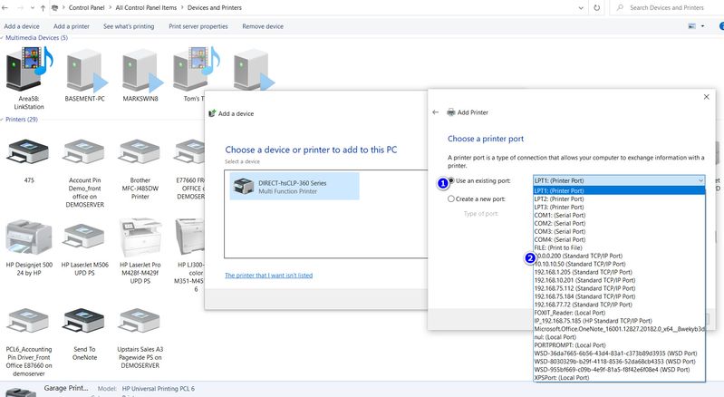

I have no USB printers on my system so I do not have any usb ports but you will see a list similar to the com ports I circled usually labelled usb0001, usb0002 or something similar. You try each of those ports.
Here are the steps to manually install the printer. Where you see my selection of a com port you should choose the first usb port on your list.
First go to control panel>devices and printers and the click "add a printer" on the window that opens to search click on the  "the printer I want is not isted" which opens  the "find printer by other options" windows where you click the last option which is manually install then click "next"
The "choose a printer port" window will open and you select existing port and then select the first USB port that you see listed and click next.
You are the a printer driver. You can select almost any HP laserjet driver for this step, I show the UPD driver because I use it for most of my printers.
If promted to use or replace driver select "replace"
Give the printer a name you can easily find.
Once this is done, run the 1536 firmware update tool and select the printer name you gave this manually installed driver and perform the firmware upgrade. If the printer shows receiving upgrade  you are a winner first try. Wait for it to finnish and you should be back on the road. If the printer does not show receiving upgrade, wait until the firmware update program finishes, then go back to control panel>devices and printers and right click the icon for your printer, select printer properties and change the port on the driver to the next usb port until  you have tried them all. If none work then at that point I would suggest looking for a replacement.
