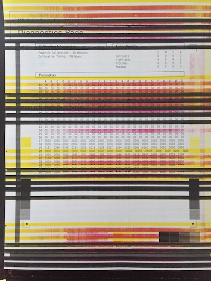

My HP Color Laser Jet CM1312nfi  MFP is printing 1/4 wide colored lines horizontally across every page. It also makes a haze of blue--what looks like tiny dots spray of ink--vertically down the page mostly on the right side of the page. The black ink cartridge is new, the color ink is on override. As I do not use it and do not want to spend all that money on new cartridges.  Obviously, the printer will not work if I remove the color cartridges. Please, assist.

If that's a yes, I recommend sending a picture of the diagnostic page you've recently printed as a part of step 2: Check print cartridge status,
This would help us determine if this is either a hardware or a software issue, basically, if the diagnostic page contains the lines - it's a hardware malfunction and the print head may require a replacement.

Hello-
I have done all of steps 1-8 that you listed. For some reason this is not allowing me to add a picture, I used "insert image" "from my computer" browsed files and chose, but it is not attaching.

@mlcal
Thank you for responding,
It's great to have you back 😉
I appreciate the image, helps a lot more than you know 😉
That said, when you use the copier as a stand-alone printer, does the issue persist?
If it doesn't, please follow the steps mentioned on this link: Click here
If it does, Simply Contact HP phone support as its a hardware malfunction:
