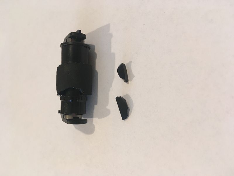

The printer had a paper jam, so I opened up the back and pulled out the paper. I had also pulled out Tray 2 and when I went to slide it back in I found a broken bit under the printer. It looks like a roller, and I've found replacement rollers that look the same, but I need to know exactly what tray the roller is for, unless they are all the same and there is no difference between the trays? How can I figure out where the roller came from? Or can anyone identify the roller from the photograph?IMG_2779.JPGIMG_2778.JPG
That is the tray 2 separation roller. You will need to replace it as it is damaged. It sits under the pickup roller in the back of the paper tray cavity.
https://support.hp.com/ca-en/document/c02680140
