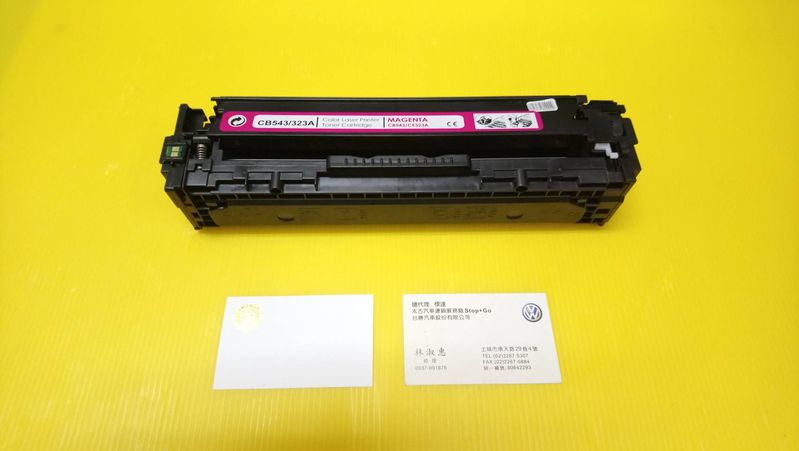

It looks like that you have to replace both the yellow and magenta toner cartridges.
But before you're doing that you can try to clean the cartridge's waste bin to see if you can save them back.
You will need a few pieces of business cards and a garbage can which used to collect the wasted toner powerder.
Do as the pictures show you.

Thanks for that.  I did try using a biz card in all the cartridges and it seems to have reduced the streaking but there are still very faint streaks of black.  I had a kitchen sink full of black toner!
