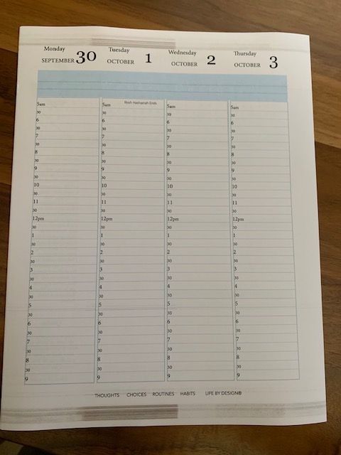

Hello,
I am printing up a planner of 100 sheets of 8.5 X 11 paper, printing on both sides, and I notice that on some pages a horizontal 1/2 inch band of grey will sometimes print on the top and bottom of each page, sometimes very fine smaller grey lines will appear cross the tops and bottoms. I have also noticed that very fine grey lines ( almost unnoticeable) will appear on some pages within the bottom three inches of the page. It's frustrating because I need to have the planners printed without these lines. I am wondering what I need to do to correct this ?.

Can you post a sample and be sure to note redirection of feed. I ask this because if you are feeding letter paper long edge first but printing portrait mode, there can be confusion as the defect is horizontal on the print but vertical based on feed direction. Most common issue we run into on this engine is transfer belt. How many pages are on the printer?

07-21-2019 12:48 PM
Hello , I attach a photo below. The printer loads the paper from tray 2 (middle tray), and the direction of feed is left to right. I have had the printer for a number of years but haven't really started using it until this past month. The ink cartridges are full and I notice the ink toner reservoir has next to nothing in it. I am not sure how to determine how many pages are on it. Thank you.
07-21-2019 12:57 PM
classic signs of problems with transfer belt or secondary transfer roller. Is the firmware up to date? Early models had issues with transfer that were fixed with an update in the firmware. If belt is too damaged you may need to replace it.

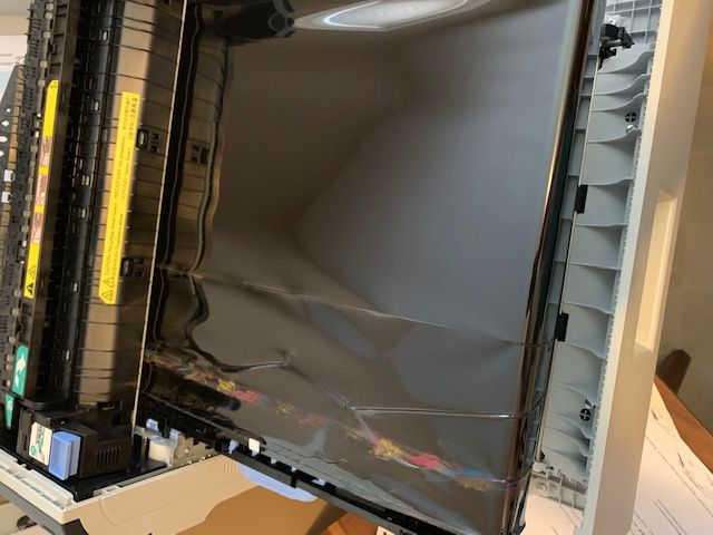

So I purchased the HP transfer belt maintenance kit and replaced the transfer belt and rollers ($460 ouch !) and it has printed wonderfully well for the past two days. I printed up maybe 1000 pages without streaking. I turned the printer on this morning and went to print one of the planners I have been printing over the past few days, and I noticed a " crinkling noise" coming from the printer. I cancelled the print and removed the transfer belt for inspection, and it looks like the transfer belt is creased in certain areas, the few pages printed before cancelling show large streaks. This is so frustrating, I need to depend on this printer. Would you have any ideas why this might have happened?. Is it possible that it was a defective belt ?. I bought it through a place called PrintersPlus and will be calling them on Monday, but I was wondering if you had any insight or suggestions ?
