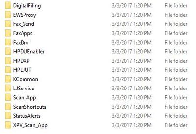

Re-installed from Disc. Previous install was removes as you said.
Install completed. NO Fax, NO Scan apps. There a device manager entry.
There is not a usable scan nor fax device.
Ther are programs on the install disk that are not being installed.
How do I force these features to install? Desperately need both FAX and SCAN.
