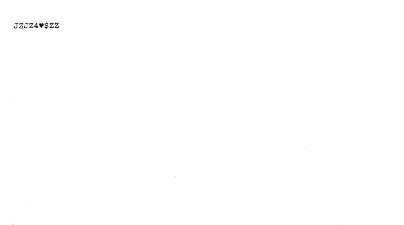

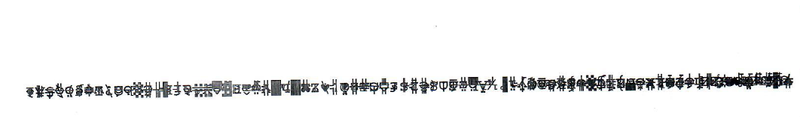

The issue is still not sorted. Attached is a screenshot Capture 1.PNGCapture 2.PNGof the test page that the printer is automatically printing,
Please assist with this.
That looks like the output you would get if sending a print job with an incompatible driver or bad connection cable.  If the printer is networked then it could be a user inadvertently sending a job. If you have the printer connected to network,  the easy way to see if another user is sending the print job is to change the IP address of the printer and see if these print stop.
If you find the information provided useful or solves your problems, help other users find the solution easier by marking my post as an accepted solution. Clicking "yes" on "was this reply helpful" also increases the chances that this solution will help others.
I am a volunteer, offering my knowledge to support fellow users, I do not work for HP nor speak for HP.
What you're seeing is actually character representations of the printer data being sent to the printer, but it is all computer code that is supposed to be deciphered by the printer if it is given the right info to decode it correctly. It is caused by any number of possible issues: 1) the printer driver for that printer has become corrupted, by any number of causes, including operating system software updates; 2) the wrong printer driver is being used for that printer; 3) a different printer model is configured to send it's data to your printer instead of the printer it's supposed to go to (i.e. the wrong IP address on a network is set, as repairatrooper alluded to). Changing the IP address of the printer and correspondingly in your printer driver should isolate it from any errant files being sent from other users/computers that may be causing the problem. If it then continues, then it may be a problem with your computer driver. Delete and reinstall driver.
