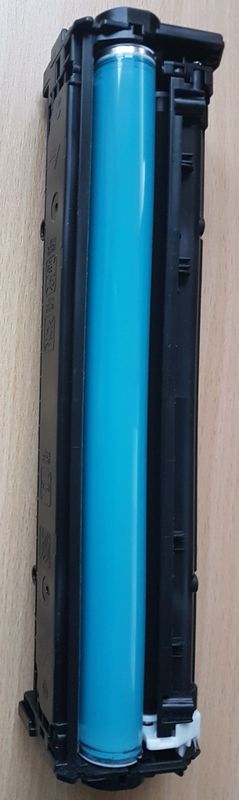

Thanks for this info - I did some further investigation and found out the problem. When I checked the toner cartridge I saw that the drum (I think - I'm not too familiar with the different parts of a cartridge) had a solid black band of toner across it.
I cleaned the toner off using a soft tissue and did a few test prints which all came out OK. In my haste to fix my problem, I forgot to take a photo of the toner cartridge that shows the problem but below is a pic showing the cartridge after I'd cleaned it and done a few test prints - you can just see the toner is starting to build up at the edges of the drum again, assuming that the blue thing is indeed the drum.
I'm assuming that cleaning the drum would NOT be the recommended approach from HP but as the cartridge is still at 70% capacity, I'm going to stick with this approach for now until the cartridge is empty and then try a new cartridge to see whether or not the same problem occurs; this should help determine whethe the problem is with the cartridge or with the printer itself.

12-31-2017 04:54 AM
The roller inside the door is perfect.I think you should just replace the drum unit.If the drum has a scratch on the drum it can arc and produce the black prints.Hope this will help.
