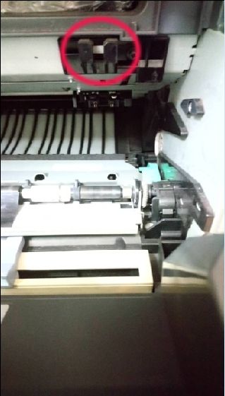

 Printer hp LaserJet 2015 prints only blank pages.I changes scanner assembly and cartridge from other printer  but the problem is remain. can help me any one to thius problam.thanks.
Power off ->  unplug all cables but power left -> power on -> keep pressing green button for almost 3 seonds until lights flash -> release.
Will P2015 still prints blank page?
If it did then you may have a broken plastic stick which used to open scanner's door when you close the front door.
If it's right for you then you just need to insert a paper or anything into that scanner door on/off switch and make it fixxed all will be fine.
