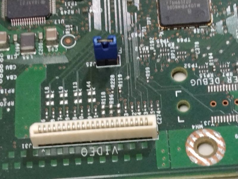

If M276 won't come to ready you'll not be able to send firmware when it's this case you can take the right cover off then there're two pins beside of the usb port or somewhere. Find them out and just short circuit then power on M276 and you'll see "Ready to download..." on the screen, now you can send firmware.

What's in the pictures is HP CM1415's formatter not a M276 so it may look different.
It shows where those two pins are and hope it helps.
