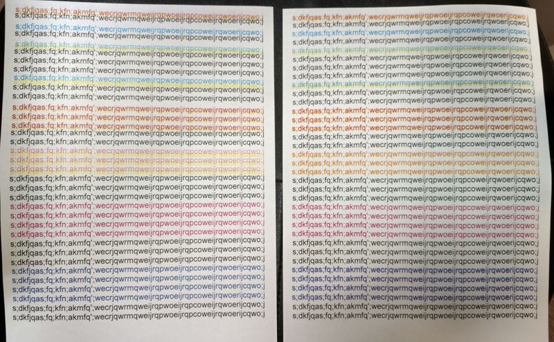

So, I have the printer software installed and I am able to request a calibration and it states that it completed successfully, but the results are many times worse than before the calibration.  Black print seems to be fine and pink lines seem to be fine.  But the red, green and some blues lines are not right at all.  It almost seems like anything requiring some yellow is the problem.  I purchased OEM print cartridges as well.  Check out the photos to see what I mean.  The sheet to the right was printed BEFORE I calibrated and the left was immediately AFTER.  I also attached the Word doc that goes with the printouts. I need help with this please.

Try the following prints.But you might hae a faulty yellow.

Do the firmware update if your current printer firmware is lower than 20140616
https://support.hp.com/us-en/drivers/selfservice/hp-laserjet-pro-cm1415-color-multifunction-printer-...
To check current firmware you can print a configuration page from printers menu and of the first page you will found information about firmware.
Next step is to turn your printer OFF, remove all cartridges, turn the printer back ON, wait for the printer to initialize when printer prompts you to install cartridges but them back in, wait for the printer to calibrate and then repeat calibration 3 times in a row from printers menu:  System setup -> Print quality -> Color calibration -> Calibrate now
