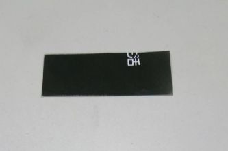

When you clean off the Sticky Solenoids you will need to put somrthing in between to provent it bacomes sticky again - it will become magnetized .
What I did before I put electric tape now I just put a V-shape paper it's more easier. It will work a long .....long time.
You have three Solenoids needed to  be taken care of, tray1 tray2 are in the 2300,tray3 has its own and seats at right side of tray3 pick-up roller and covered by a cover needed to be take off first to get to it.
If you want you can use a Double-sided tape for them but it might be not necerrary because of  it is sticky already.
