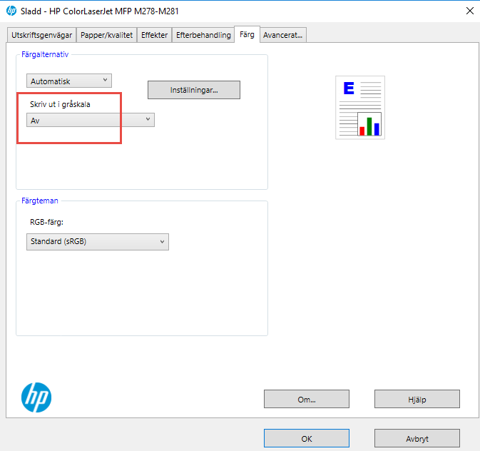

Try making copying something in color, if it does a copy in color then try the steps below to change the setting on your computer

Select Color or Black & White on the Paper/Quality tab
On the Color or Features tab, or in Advanced Options, click the menu next to Print in Grayscale and select Off for color prints, High-Quality Grayscale, or Black Ink Only
Under Printer Features on the Advanced tab

I can copy in color so the printer itself is just fine.
And yes, the toners are HP original.
Unfortunately the tips don't solve my problem. Greyscale is off in the settings. :Crying:
Got any other advice?
