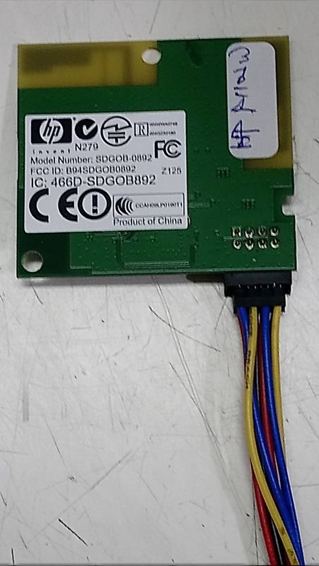

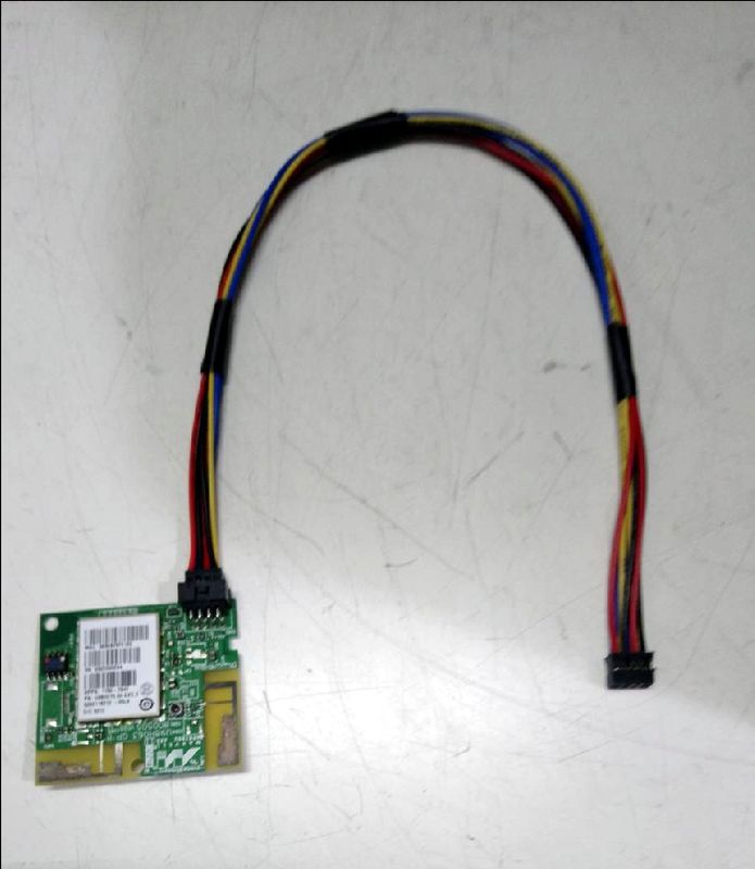

Yes, it will.
With a HP Wireless PC Board Assembly Antenna Card (HP PN: 0960-3295) HP M477 fdn will turn to be a M477fdw.
These two pictures are from eBay.

I installed Wireless PCA (M377, M477fnw/fdw) 1150-7967 / the part you replied with is for the M452 0960-3295 is it the correct pcb? and of course I upgraded the firmware updated the driver but even with the printer not connected to the pc  there is no wireless in the network menu or anywhere else in the menu
I'm sorry! My bad. I thought they are inter-exchangeable. Good for HP!
I google just now and found the right Part number should be 1150-7967.
Hope that you can return it and get the right one back.
I have the correct one installed but the printer just wont see it. been looking for a solution but no luck. I'm thinking that either the formatter needs to be replaced  but when I look for the updated board part# CF379-60003 they all say part on board is CF379-60001 and thats what I have. so maybe my wireless board is DOA I just dont know!
The formatter part number you list in your original post is identified in the service manual as for the M477FNW. It is quite possible that the boards are tattooed at the factory to be either wireless yes or wireless no and not be changeable. As well, configuration data is stored in multiple areas and replacing the formatter may still not result in giving you a wireless printer.
