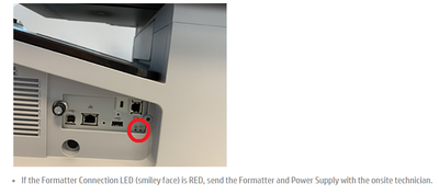

We have a HP Officejet Enterprise Color MFP X585 and it keeps getting a 61.00.00 error. I've tried the tips from here, such as reseating the formatter, as well as tips from this video, and the green light in the control board is lit.
I formatted the hard drive in the pre boot and installed the latest firmware, from earlier in 2020. The 61.00.00 error returns. I entered a static IP address in the pre boot section but the device is not responding to ping nor via a web browser. Just the 61.00.00 error and the prompt to restart.
Is this likely a situation where we have to replace the formatter?

According to tech documentation if the smiley face LED is green the formatter is ok.
