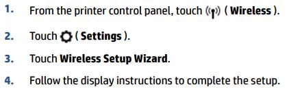

Once the network defaults are performed, let us re-run the wireless setup wizard by following the below steps:
