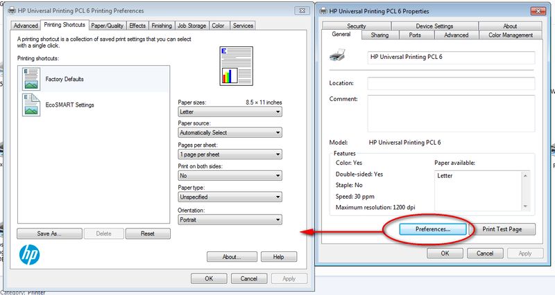

Just to be sure I am clear, are you creating multiple "driver instances" for the printer and mapping each of those with a different share name? If so, setting the print preferences on the driver instance for each share should force the correct output. Unless your legacy program is creating PCL codes that the 402 misinterprets.
