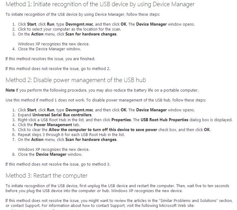

The firs thing I suggest is to run Windows update.  Open Internet Explorer and click on the "Tools" dropdown next to "File" at the top of the window. Click on Windows update and click yes if prompted.  You should be taken to the Windows home page.  Click "express install" and it should search for updates.  Install any updates available and restart the computer.
If that doesnt work I have provided some troubleshooting steps bellow.  I was able to locate them from http://support.microsoft.com/kb/871233.  They may help resolve the issue!
Let me know if that worked out for you!
