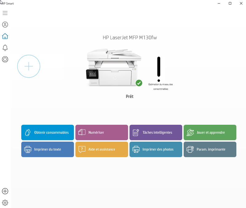

I am unable to print from my PC but can from my Mobile iPhone.... Each time i print from word, pdf... it says " Print Error ". I try uninstalling all, and installed from scratch with latest drivers. I have also use the HP Doctor http://ftp.hp.com/pub/printers/hppsdr/patches/HPPSdr.exe and restart afterward.. same issue. Unable to print.
explorer_lswxcGfO3o.pngApplicationFrameHost_lC5WUQAwfA.pngApplicationFrameHost_3UV7d334sO.png
Can some one guide me pls ? Thanks. Urgent....

Hi, I follow your advice and got the same issue.
here are the settings I got.
Thank you for your prompt reply.
I am available via chat on skype if needed or via a remote control if this is faster ?
Let me know...

A RJ45 cable goes from my Fibre-Modem to my office room. Plugged to a little Switch NetGear 8 ports. From there, one RJ45 cable goes to my Desktop computer Win10 and i got internet access just fine. My Desktop ip is 172.22.22.225.
A RJ45 cable goes from the NetGear switch to the back of the printer. The printer IP is 172.22.22.142 and I can access the Webpage with all the configuration. When I open the Printer page from the Windows settings, I can see a FAX (don't give a **bleep**, not using it), and 2 printers now, both... offline.
My printer is connected with RJ45 and switched ON.... Getting lost and just want to smash it on my garden patio.... Driving me insane... I can, however, print from my iPhone....

Hi, thanks for your reply. After following your step, I have no form to fill and create a new case. Sadly. I have checked my product since it is registered and covered for next 11 months under warranty.
See the picture, the options I have.
