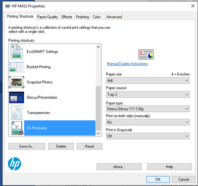

Thanks for the feedback. I tried to make sure everything is set to 4x6.
Screenshot of Printer Properties
Printer Screen
Paper loaded
After I the first page prints, the printer goes into cleaning after which, this is what is displayed.
Error after printing first page
What I do not understand is that the printer keeps going back to "letter." I must be missing something....
I do have the most recent driver and firmware.
Thoughts? Thanks again in advance!

I can see your images now.
The prompt on the printer stating "Load tray 2 Hvy Glossy, 4 x 6" implies that the incoming print job has requested media (paper) of size = 4 x 6 and type = Hvy Glossy
So this is what should be configured on the printer itself (via front panel menus, or the Embedded Web Server equivalent).
Paper size is usually detected automatically (at least, for standard paper sizes) via sensors attached to the length and width guides in the cassette tray; I'm not sure if this applies to lesser-used sizes such as 4 x 6 - it may need to be set manually.
Paper type is not detected automatically, so this must be set (via the relevant menu / EWS drop-down list).
The unexpected paper size prompt is probably output because the printer does not automatically detect the 4x6 size, so it believes (via the front panel / EWS configuration) that it still has some other paper size in the tray, and when the first sheet is puilled in, the sensors in the paper path indicate that it is not the expected size stored in the configuration.
Check what the configuration shows.
