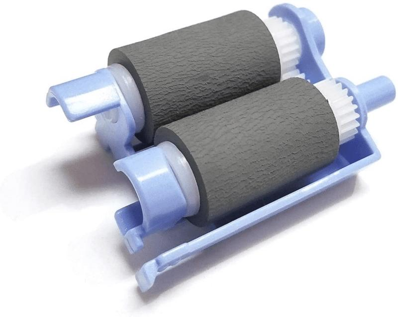

Does anyone have detailed instructions with pictures on how to replace the document feed rollers?  My printer started making a horrible plastic grinding noice so I bought the rollers and they fell apart (of course) when I pulled them out.
I do not have the blue tab on this printer.  It seems to be an older model.

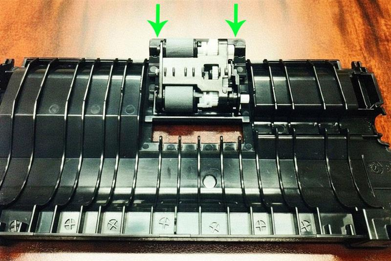

Sorry to butt in but it would appear that there is some bad information circulating around. The video below shows the procedure for replacing the ADF rollers. The 283 uses the same kit as the models listed in the title so the procedure will be the same
https://www.youtube.com/watch?v=5DSjtt0ileQ
If you find the information provided useful or solves your problems, help other users find the solution easier by marking my post as an accepted solution. Clicking "yes" on "was this reply helpful" also increases the chances that this solution will help others.
I am a volunteer, offering my knowledge to support fellow users, I do not work for HP nor speak for HP.
Today we will be reviewing the ADF parts replacement process for the HP Color Laserjet M477 M377 M426 M281 M427 M277 ADF Maintenance Kit ADF is Acronym for automatic document feeder We will be using the M477 as our demo printer today for the installation. The procedure is similar across all the ...

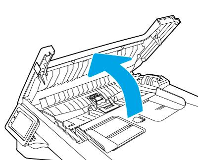

Even though your model differs slightly, HP’s standard process is:
  1. Open the ADF jam access door
  2. Locate the roller assembly
  3. Release latch (if present) and slide the roller assembly out
  4. Remove separation roller from its cover
  5. Install new rollers and reassemble

Thank you Thank you thank you.
The feeder is still grinding so it must be a cog somewhere else
The unit totally fell apart when I took it out so this was so helpful.
