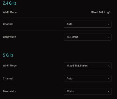

thank you very much for your suggestion! Unfortunately none of your ideas worked. I tried to play around with the 2,4 GHz and 5 GHz channels on my router and also with the bandwith of these channels (20/40/80 MHz). I tried all kinds of combinations and for a while it seemed to be working better. But then it stopped working again. I resetted all my network changes on my router and now everything is as it was before (= not working 😞 ). Does the bandwith or the network channel that my router normally chooses automatically have any impact on the behavior of my printer? That's how it looks now:
Should I change anything here?
Also I tried out Band Steering that the router offers. But I did not know whether this makes any impact and what options I should set for the devices (my laptop and printer): 2,4 GHz, 5GHz, Don't steer or Steer me. Do these options have any impact??

In adjusting the channels on the router you may need help from your ISP. And wired connections are always more reliable. The fact that wired connection works fine and wireless does not is a sign that the network may not be stable.
Also, the printer can only connect to 2.4GHz so you need not change anything with 5GHz. Ensure your computer is on the same network as printer while printing or scanning.
