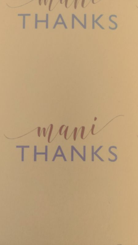

I am suddenly experiencing print quality issue.
It started to happen today.
Please see below photos I've attached ( I've also attached the diagnostic page, supplies status, print quality test)
I've done "hard reset" my printer + "HP LaserJet Pro 200 Color M251n and M251nw - Troubleshooting Print Quality Issues",
but could  NOT resolve the issue.
I don't recall changing anything...(same papers, same print options...)
I tried to print using different computer, but issue still happens.
Nothing was found on cartridge + drums neither
This is really frustrating..
Thank you in advance for your help
Here is my printer info:
Model:   HP Laserjet pro 200 color M251NW.
Product No:  CF147A
IssueIssueNormalNormalDiagnostic PageDiagnostic PageSupplies StatusSupplies StatusPrint Quality TestPrint Quality Test

Printer Firmware: updated to latest.
Connection: USB
Tried hard-reset.
I did all "HP LaserJet Pro 200 Color M251n and M251nw - Troubleshooting Print Quality Issues".
The issue still persists...
I am checking adobe illustrator configuration one by one.
@oxox,
I am responding on behalf of @Jeet_singh as he is out for the day. It is great to have you back and your patience is greatly appreciated.
If you have followed all the suggested steps in the previous post and still facing the issue, then it is a hardware issue with the product. I will share you few details through a private message about the service options dedicated to your product, please watch your inbox for more information.
