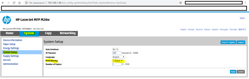

I would like to set toner consumption to the lowest level possible on my new HP LaserJet Pro M28w
Using windows 10 x64 + wifi connection through router (if that means anything in the given context)
The only relevant setting I cam across is "density" is system settings tab (printer "admin page" that you can see navigating to it's IP in your web browser)
I see values from 1 to 5. Whatever I choose I still see very dark\dense printing and as a result my cartridge won't likely live long with that
Am I doing anything wrong?
Any other settings one can try?
Can I somehow get working density setting in Windows 10 probably? (In user manual I found quality\density settings
description for OSx only)
Any relevant comments are welcome
Thanks in advance for your time and energy
UPD: The setting I'm mentioning can be found in User Manual
http://h10032.www1.hp.com/ctg/Manual/c05847830
p 77 "Adjust Print Density"

Hi!
Unfortunately my long and nice reply was marked sa spam by whatever system or a human moderator you guys have there
In short:
1) I'm using the original cartridge preinstalled in my new printer. I didn't refill\replace it
2 - 4) I don't have such settings\ features. Neither "Clean page" nor "Quality settings"
Neither do I have such settings in "HP Smart"
Only here (as per the mentioned User Manual, in EWS)
But it doesn't work. No difference between pages printed with "1 (light)" and 5 (dark)

Hi!
I did this before and I've just repeated the process again
Still same results
Any more workarounds?
Any ideas why printing density setting from EWS does not work? It's described in the manual, it's not a part of OS\drivers. It's HP's own firmware and it produces zero effect. Does it feel like smth is broken?
