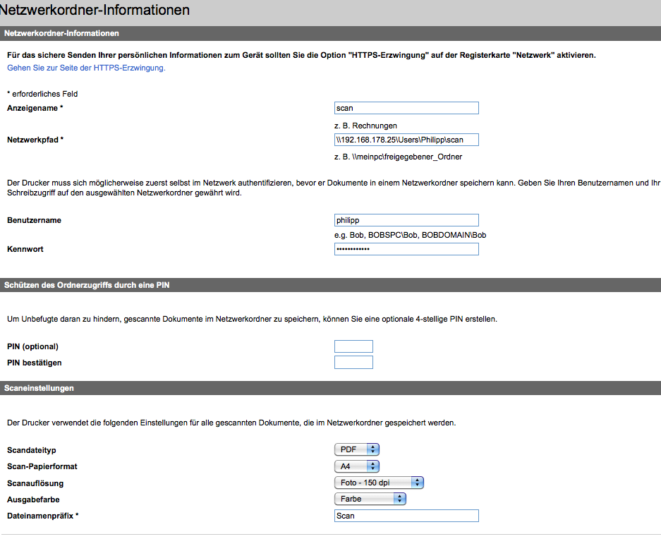

ok i found the error:
http://support.apple.com/en-en/ht1568
DO NOT enter the path to folder.
ENTER the SHARENAME of folder.
eg. //192.168...14/scan
NOT //192.168...14/users/jondoe/documemts/scan

04-13-2016 10:45 AM - edited 04-13-2016 10:46 AM
HOLY CRAP! Thank you so much! ALL the dumb support option needs to say (in the instructions would help) and then no screen shots would not even be necessary is:
USE the numbers found below File Sharing On and file name only, example:
THIS -->//192.168...14/scan
FINALLY! SHEESH
