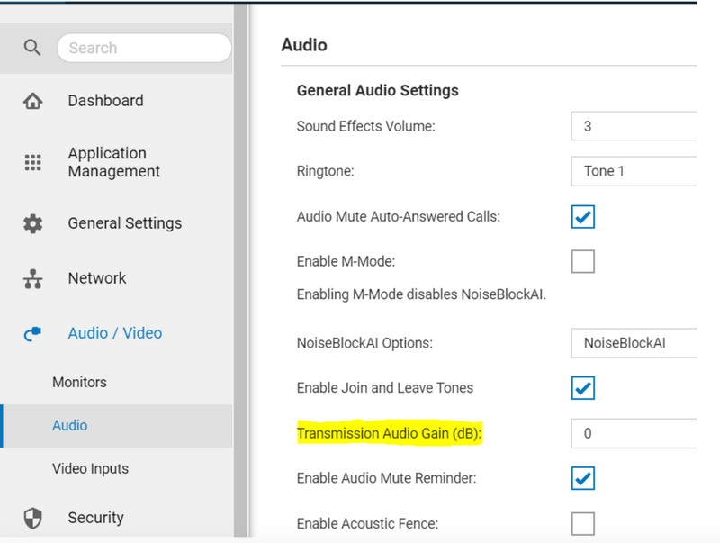

We noticed an audio suppression problem in MTRoA equipment, when the user in the room speaks together with a remote user, the audio is suppressed, we opened a ticket to Microsoft who recognized the bug and were informed that the echo cancellation and AGC were disabled. Making the MTRoA equipment audio lower, it is necessary to increase the microphone dB gain to 18 as a workaround. The same will be resolved in Poly OS version 4.1.0

Hello @Aluizio Deodato , @FlashPan
please check:
*KB Article 66573*
Tech Alert:
  • Customers may have low Microphone send level from Studio X30 and X50 devices to the far end of a call starting on June 5th 2023
Products Impacted:
  • Studio X30 and X50
Issue:
  • HP Poly has been receiving customer escalations around audio echo and doubletalk customers using Studio x30 and x50 devices along with customers reporting low mic send levels from Studio X30 and X50.
Root Cause:
  • HP Poly engineering investigated these issues along with Microsoft and found that there was an issue with how the audio was being processed between the cloud and the devices.
Fix:
  • To fix this urgent issue the decision was made by HP Poly to make an emergency change to offload all audio processing from the cloud to the local Studio X30 and X50 devices in the field.  The local devices in the field can manage the audio efficiently. While this change immediately fixed all the echo and doubletalk issues, as a result some customers may experience a noticeable decrease in the “send” level of the mic to the far end when joined in a call.
  • If customers experience the MIC “send” level being too low, this can be fixed through the Studio X30 or X50 web interface by setting the MIC send level to 14db – 18db based on preference.
