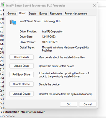

 I select Advanced troubleshooting of input device I get this
in the recording tab, there you should have Stereo Mix as a default, but that is not a microphone.
- if I can help solve your question or issue, please click on ACCEPT AS SOLUTION or click the YES button if my answer was helpful.
The issue happened to be with this particular driver,  I had done an update.  My mic stopped working.  Once i rolled it back to use this driver, my mic has been working again.  The 2024 Driver update caused the mic to stop working.
