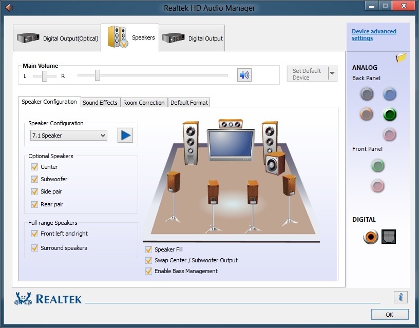

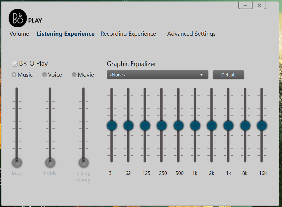

My laptop has Realtek HD Audio drivers with so hated B&O Play sound manager.
Question would be how to get back old good Realtek HD Audio Manager?

Hey David.
B&O Play sound manager is preinstalled by default so i dont think intalling drivers back via recovery manager will be a fix for my problem as i will get back B&O. 🙂

Thank you David, the drivers you provided via link works perfect after all version of audio drivers are removed from windows driver store and i get back old realtek HD audio manager. All seems to work good untill you want to update drivers as your ones are made in 2015. So if i go update drivers from via driver update i get back drivers made in 2016 and B&O as well, if i go and install drivers dorectly form realteck website, made in 2017 i get B&Q back as everything is tied to windows update server driver store.
The fix would be to get updated driver package with old ha audio manager in it, install it and in pilocy settings to set up forbid device installation by device ID.
If you have a link to newer driver this would be superb and i could play a bit more 🙂
At the moment im staying with B&O Play manager and new 2017 drivers.
Regards.
